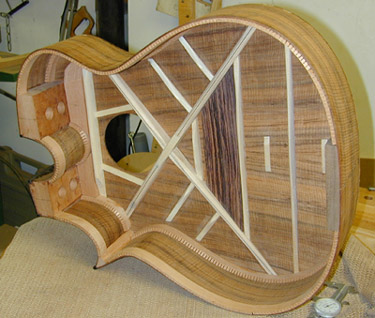

BTW Tony MY next build (now using walnut for the neck as well as the back & sides) will be a 6/12 double, so I'll be spending a LOAD of time looking at this pic.......

You may want to stare at this one for a while then too ...

Tony You got my attention with that one!!!

Ahhh! Tony nails me to the wall on that one!
What's wrong with you, haven't you ever seen rodewood?

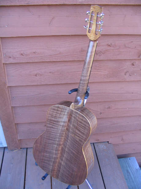

Here's one of mine. That's walnut for the back, sides, and neck.
Todd Rose
